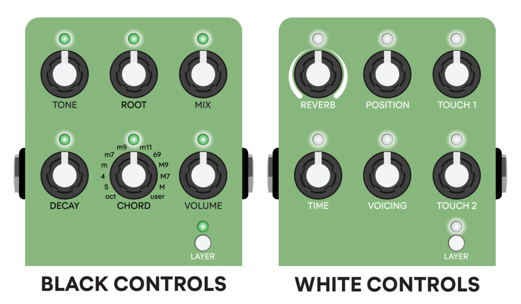

Tap the LAYER button to select between editing black or white knob controls.
The LAYER LED lights up when you are on the white layer.
Visual feedback
- Black controls glow a gradient of green.
- White controls glow a gradient of white.
Each control has its own LED that conveys the real-time intensity of the setting, changing in brightness as you rotate the knob.
Relative knobs
When you switch between editing black and white controls, the physical knob position might not line up with the real-time setting.
When this happens, the control becomes relative, meaning the knob adjusts the parameter based on the amount of space available until they catch up and start tracking again.
We do this intentionally to avoid sudden jumps during live use.
It sounds complicated but it’s really simple — just use your eyes and ears when adjusting the controls.

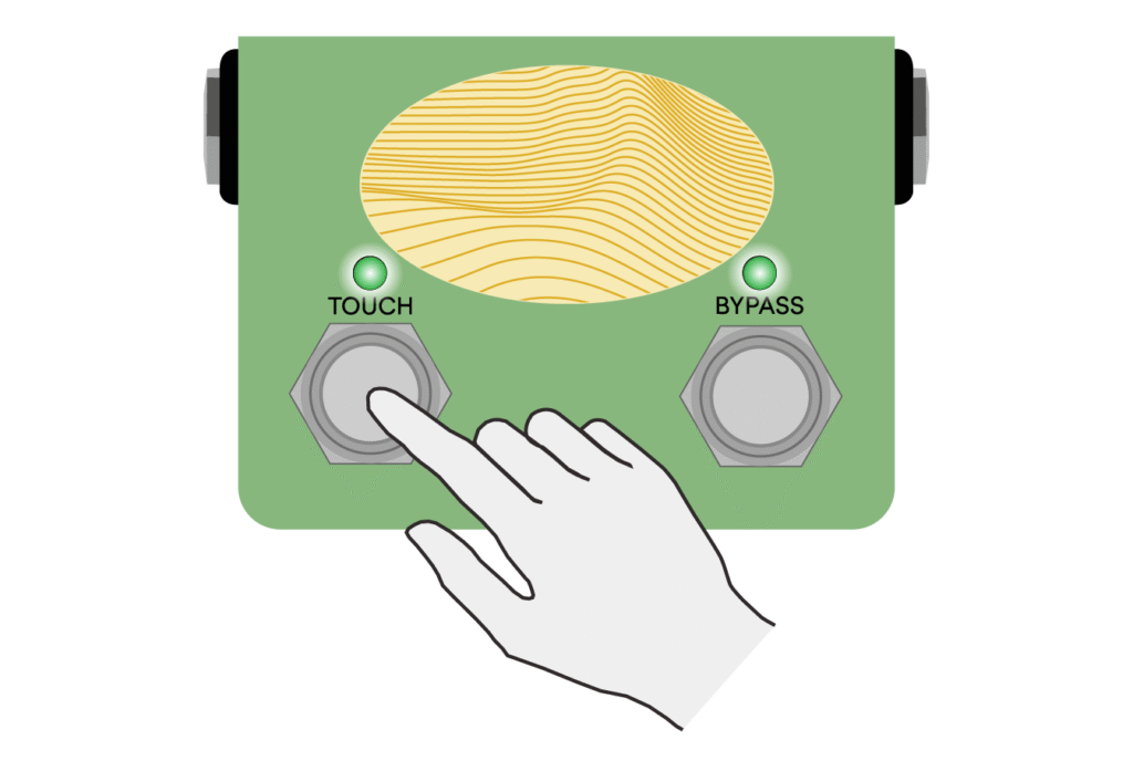

TOUCH footswitch
The TOUCH footswitch engages your selected Touch Mode.
This can be a granular processor, a varispeed looper, a drum machine, or a frequency shifter.
The footswitch responds to latched or momentary presses. You can use it for “always on” effects — or quick performance effects.
Each Touch Mode has two main knob controls (TOUCH 1 and TOUCH 2 on the white layer).
Touch Modes are covered in their own section, but this footswitch is a core part of Ghosts’ interface.

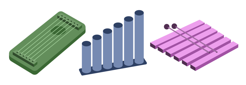

At the core of Ghosts are mathematical models of 6 strings, tubes, or bars that you can excite and transform in real-time. These are the “resonators” — they can produce anything from lifelike, acoustic tones to strange and otherworldly sounds.
MODEL button
Tap the MODEL button to choose your resonator type.
The MODEL LED indicates your selection:
STRINGS (green LED)
Based on the Extended Karplus-Strong algorithm. Compared to standard Karplus-Strong, this model more accurately captures the sound and behavior of real strings by adding damping, and the ability to adjust the excitation position.
Strings produce harmonic frequencies, meaning overtones that are whole-number multiples of the fundamental pitch.
TUBES (blue LED)
A type of modal resonator. Ghosts emulates modal resonance using a bank of 18 virtual-analog band-pass filters per voice (that’s 108 band-pass filters in total!).
Unlike plucking a string, striking a tube produces inharmonic frequencies, or tones that are not whole-number multiples of the fundamental, which gives them a rich and complex character.
BARS (pink LED)
Another type of modal resonator. Like tubes, bars produce inharmonic frequencies, but the overtones are more widely spaced and detuned, resulting in a brighter sound.
Because of its harmonic content, STRINGS is the most universally pleasing model on a wide range of input material.
TUBES and BARS pair especially well with percussive sounds, the contact mic, and the internal exciter (PLUCK / STRIKE or AIR).

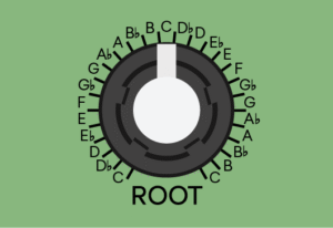

ROOT
Adjusts the root note of your selected chord, quantized to semitones. Middle C is at 12 noon, and you can pitch shift +/- an octave from there. The LEDs blinks as you step from one note to the next.

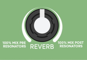

REVERB
Controls the reverb mix + placement, so the amount of reverb, and whether it’s placed pre- or post-resonators. If you are playing Ghosts as an instrument with the internal exciter (PLUCK / STRIKE or AIR), place the reverb post.
Let the space excite the model — or let the model excite the space.
Placing the reverb pre smears the input, creating a soft, cloudy drone that stirs the resonators.
Placing it post provides greater spatial definition, which is ideal for a more traditional reverb effect.

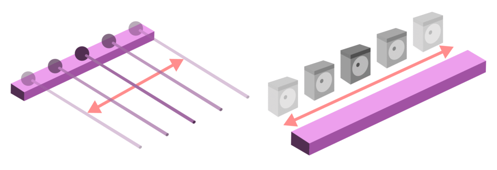

POSITION
A model-dependent control that sets the physical excitation point along the resonators. This adjusts which harmonic overtones are emphasized.

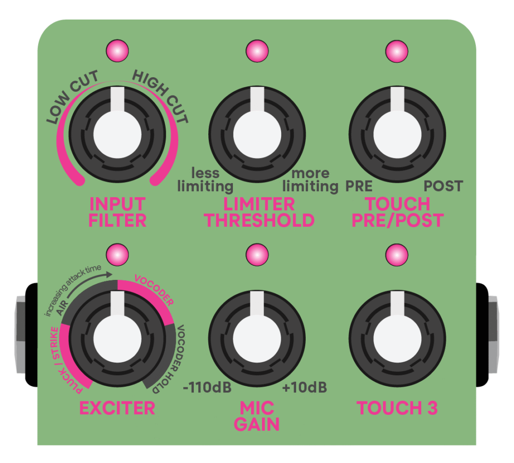

Hidden layer
There is a third layer of knob controls that provide some additional utilities. For the most part these are set it and forget it settings.
Hold LAYER and tap MIC to enter the hidden layer.
The LEDs light up pink to indicate that you’re editing hidden controls. Tap LAYER to exit.
INPUT FILTER — TOP LEFT KNOB
An input low-cut or high-cut filter to sculpt your incoming audio before it hits the resonators. Adjust this control in relation to your particular setup.
A tip for guitar players:
Try engaging the input filter a bit left of noon to roll off some low-end.
This results in the upper harmonics of your instrument exciting the resonators instead of the fundamental — reducing harmonic buildup and leaving you with a more focused sound.
LIMITER THRESHOLD — TOP CENTER KNOB
A brick wall output limiter to tame the resonators. Turn up this control if you experience unwanted volume spikes. The limiter is always engaged but set to the minimum by default.
MIC GAIN — BOTTOM CENTER KNOB
Adjusts the gain of the contact mic. The range is different for instrument level and line level, but between about 12 noon and 2 o’clock is generally a sweet spot.
The mic is extremely sensitive at high GAIN settings! Experiment with caution to protect your hearing and avoid feedback.

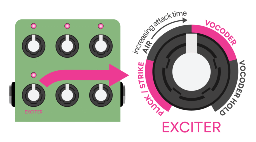

EXCITER — BOTTOM LEFT KNOB
Selects the exciter type. This control applies if you are using MIDI notes to play Ghosts as an instrument.
TOUCH PRE / POST — TOP RIGHT KNOB
Touch Modes can be placed before or after the resonators, with pre as the default. Use this control to toggle the placement.
TOUCH 3 — BOTTOM RIGHT KNOB
Provides an optional utility for each Touch Mode:
- TERRAZZO — Dry / wet mix
- ENDLESS LOOP — Loop volume
- RHYTHM GENERATOR — Drum volume
- SHEPARD SHIFTER — Dry / wet mix

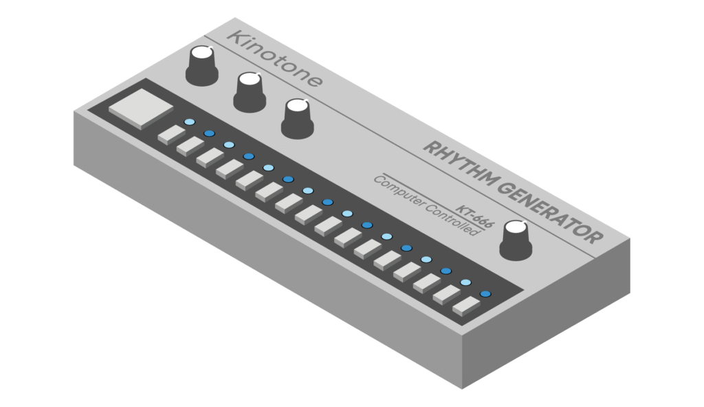

TERRAZZO (green LED)
ENDLESS LOOP (red LED)
RHYTHM GENERATOR (blue LED)
SHEPARD SHIFTER (pink LED)

You can latch the TOUCH footswitch or engage it momentarily. These have different use cases.
- Latching — Quick tap TOUCH to engage, then tap again to disengage. Latching is for “always on” effects.
- Momentary — Keep TOUCH held down to engage, then let go to disengage. Momentary presses are great for brief performance effects.

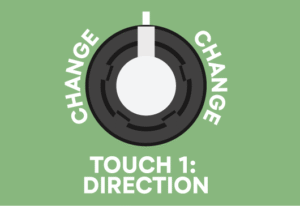

TOUCH 1 — DIRECTION
This knob works just like bi-directional recording on a tape player. You can record and play in both directions.

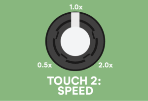

TOUCH 2 — SPEED
Use this control to pitch shift your loops. Speed varies continuously from 0.5x to 2x, and impacts maximum loop length.
Record up to 40 seconds at 0.5x speed, 20 seconds at 1x speed, or 10 seconds at 2x speed.
RHYTHM GENERATOR
Rhythm Generator is a virtual-analog model of a legendary 1981 drum machine with punchy analog resonator circuits. Resonators to excite resonators! Kick, snare, hi-hat. Real-time synthesis (no samples).
TOUCH 1 — PATTERN
Selects between 11 curated patterns and a 12th Euclidean random notch. The 12th notch algorithmically generates a brand new pattern each time it’s re-selected.
TOUCH 2 — TEMPO
Adjusts the tempo of the drum pattern.
To use Ghosts as a standalone drum machine, set DECAY to zero to bypass the resonators.

The input signal is gated by default. Incoming audio and the contact microphone are muted unless a MIDI note is held.
CHORD, ROOT, and VOICING are bypassed. Ghosts is no longer listening to to these settings — you have complete control over the resonator tuning with the notes you play.
We gate the input by design. Without gating, all 6 voices would be constantly reacting to the input, creating a chaotic 6-note drone and making it impossible to play clear melodies.

To exit MIDI Takeover Mode, Twist the ROOT knob. This tells the resonators to resume listening to the CHORD, ROOT, and VOICING knobs.

The exciter is what sets the resonators in motion. It’s the hand that plucks a string, the mallet that strikes a bar, or the air moving through a tube.
But your input audio or the contact mic can also be the exciter.
The EXCITER control determines how Ghosts responds when you send it MIDI notes.
internal exciter
PLUCK / STRIKE or AIR are the internal exciter options.
If the EXCITER control is set to either of these positions, the internal exciter is ON.
When set to PLUCK / STRIKE or AIR, the MIDI notes you play re-tune the resonators and excite them simultaneously. No external audio required — just MIDI notes.
PLUCK / STRIKE
STRINGS are plucked. TUBES and BARS are struck.
AIR
A breath-like excitation that can be used across all models. As you twist the knob clockwise within the AIR region, it increases the attack envelope time.
When using PLUCK / STRIKE or AIR, Ghosts is a complete instrument rather than an audio effect.
Try experimenting with the physical models, as well as tone, decay and position settings to emulate a wide variety of acoustic instruments.
Twist the ROOT knob to resume using Ghosts as an audio effect.
Internal exciter OFF (VOCODER or VOCODER HOLD)
VOCODER and VOCODER HOLD let your input audio or the contact mic be the exciter.
If the EXCITER control is set to either of these positions, the internal exciter is OFF.
When set to VOCODER or VOCODER HOLD, the MIDI notes you play re-tune the resonators, while the input is what excites them.
VOCODER
When you send Ghosts a MIDI note, it re-tunes a resonator voice and opens its gate, allowing the input to excite it. When you release the note, the gate closes and the resonator decays naturally.
VOCODER HOLD
In this scenario, you can lift your fingers off the keys, and the notes will be held until you play new ones (the input won’t be muted between phrases).
For example, if you play C–D–E–F–G–A then release the keys, the resonators will be tuned to those notes and your input audio is free to excite them.
You don’t need to press all the notes at once though — as long as one is held, you can add more to the stack. When a seventh note is played, the oldest note is replaced by the newest. If you release all notes and then play a chord, Ghosts clears the previous stack and holds only the new notes.
When using VOCODER or VOCODER HOLD, Ghosts is a powerful processing tool for vocals, drum machines, and more.

| 16 | Root | 0-2: C (lowest) 3-7: C# 9-13: D 14-18: D# 19-23: E 24-28: F 30-34: F# 35-39: G 40-44: G# 46-50: A 51-55: A# 56-60: B 61-66: C (middle) 67-71: C# 72-76: D 77-81: D# 83-87: E 88-92: F 93-97: F# 99-103: G 104-108: G# 109-113: A 114-118: A# 120-124: B 125-127: C (highest) |

| 24 | Reverb Mix & Placement | 0-63 = Pre Resonator Mix 64-127 = Post Resonator Mix |

The user notch on the CHORD knob serves two purposes: it lets you define a custom chord, and it lets you retune the resonators to a system other than 12-tone equal temperament.
You can also combine these functions — send a custom scale first, then set a chord within that tuning. User chord and scale are persistent between power cycles and can be saved into presets.
User Chord
To send a custom chord, set the CHORD knob to user and set the EXCITER control to VOCODER HOLD.
Then play a chord of up to 6 MIDI notes.
Tap LAYER twice and wait 3 seconds to trigger a state-save. Your chord is now stored in memory, and Ghosts will retune the resonators to this chord if the user notch is selected.
Keep in mind that loading a preset will overwrite your chord with the user chord saved in that preset slot. So if you’d like to keep your chord long-term, save your settings into a preset.

To access the Mixing / Input Level Menu, hold down the TOUCH footswitch while applying power to Ghosts. Both footswitch LEDs will turn blue.
Default settings are mono in / mono out instrument level, and analog bypass.
The MODEL, MIC, and LAYER LEDs (from left to right) indicate settings 1-3, and 4-6. Tap LAYER to toggle between them.
- To save a new setting press TOUCH.
- To exit without saving press BYPASS.
After saving or exiting Ghosts will boot up normally.
